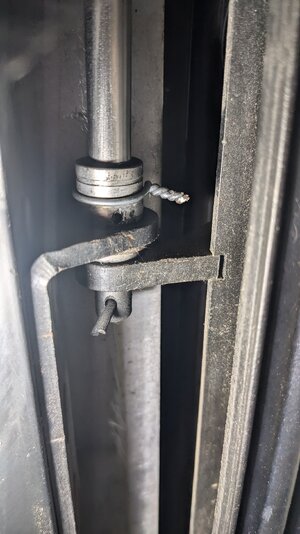

I used a soft wire instead of waiting for a clip for our wet bay door. Like it so much, I'll continue using wire. It's in use for like a year now.

Curious about the picture you included. I noticed that the hinge is sitting below the retaining ring (or in your case twisted wire) vs. resting up above/on it. Typically, the hinges rest on top of the ring (hence the issue with them dropping on their own as the ring pops out or the ring deforming just enough to pass through the hold in the hinge like a magic trick). The multiple slots in in the hinge pin grommet allows for incremental height adjustments to the hinge resting height. That said, on your rig, maybe being dropped all the way down is the best bay door alignment for you. On mine, most of my door hinges rest on top of the retaining rings.
