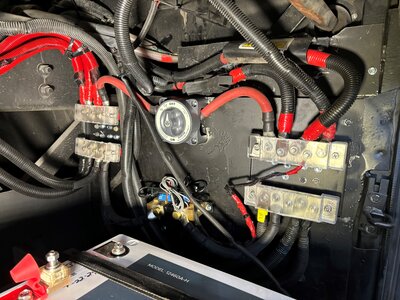

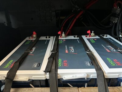

Just finished upgrading 2021 NA to three 460ah LI - OMG!

Looking at finalizing battery order today and I have a questoin please. There are two Epoch 460 Amp 12 V batteries. Both have blue tooth, are heated, have hot and cold shut offs. The significant differences are the newer one has Victron Coms, are individually fused and will to 300 Amp continuous discharge. Also there is about a 30% price difference. Am I missing something else? I have had a Cerbo set up in the past and don't see where the coms would be a deciding factor for me. With the smart shunt and bluetooth plus the panel from the Mangum Invertor I think I will know battery status. If I were changing invertor that may change my opinion but as it stands now I am leaning to the less expensive batteries and they have twice the duty cycle specs. Thanks for your input in advance. Regards

My take and speculation on what I have researched is that the Canbus connection to get actual SOC from the battery BMS is definitely more helpful than that of the calculated number. On top of that, the enclosures of these batteries are much more accessible for repairs or future upgrades or changes. The BMS quite likely is not the same in both batteries - in fact in the more expensive battery, its BMS heat sink is exposed outside for better cooling of the components. The more expensive battery also is better sealed from the elements (IP54 vs IP67). The discharge for short bursts is higher. This could be helpful in bridging situations for low chassis batteries (not likely dead, but low), and also it is not clear what cells are used in the lower cost battery - The more expensive one uses really good Eve cells. Not throwing shade on the lower cost version. I went with the best because my expectation is this will be at least 10 years in my coach. That difference, on three batteries, amounted to $180/year in that scenario. Also, check for discount codes out there. I did not pay the listed price. Check with Epoch for more specific differences.
One more thing, in multiple battery configurations, I think the BMS, because they are linked and can communicate, may balance the charge better between batteries. Might not be an issue in the early years, might make a difference later on. I don't know - again speculation on my part.

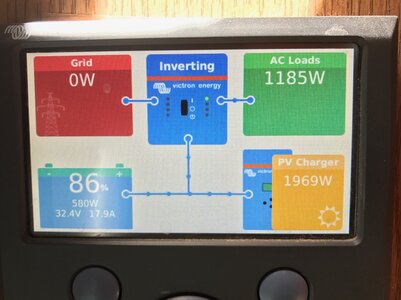

My last system had multiple batteries and all Victron equipment-Orion DC charger, smart shunt, two Smart Solar charge controllers (1180 watts on the roof) , cerbo GX, mx 50 display panel and 3000 watt invertor. I also used the bluetooth connection to the batteries to "correct" the system SOC weekly. Never off a lot where it mattered in the short term but it could have possibly become a problem over time.
