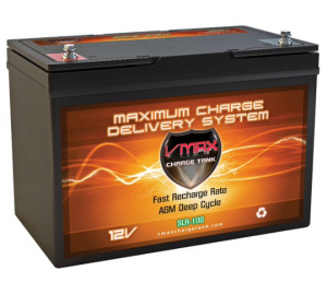

Yes I have an inverter. I now nothing about the one that is installed. Yes my truck battery is separate from the deep cycle battery. Both under the hood. The house battery needs to run the plugs, the lights, start the generator, and run frig when propane is off. I have learned I am to turn off the propane before taking off on the road. Seems very logical to me. I will need it for a TV and gaming system. I don't watch TV itself, I stream everything over the net. I plan to follow the advice of @Neal concerning what is working for him. I have found nothing better in the research I've done. I will have solar gadgets to charge my phone and laptop. I also intend to install some version of solar power. I have one battery for house, not a bank. It is 12V AGM from what I can tell. I will be doing more dry camping/boondocking than anything. Need it to hold me for as long as possible. The generator charges the battery as does the truck when it is running. The issue is generator uses trucks gas supply.
This is one I have been using for comparisons of other batteries.
  • 12V 100AH AGM Deep Cycle SLA Battery. Sealed, non spillable
  • Group 27 12 Volt 100Ah AGM Deep Cycle Battery
  • Superior Military Grade Alloys. Maintenance free. No dangerous toxic gas release
  • L=12.1" W=6.7" H=8.2"
  • Capacity: 100Ah; 1.35kWH; Reserve Capacity: 220min
  • Positive Post: Right
