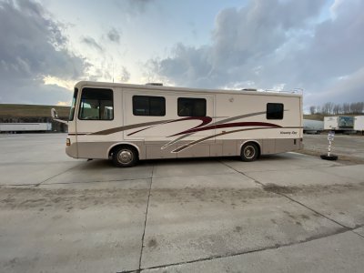

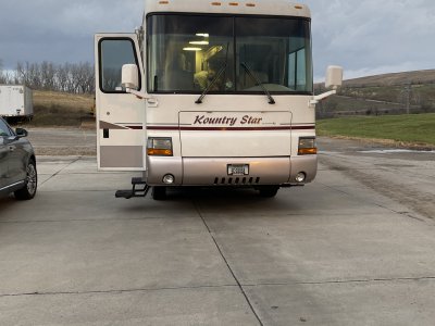

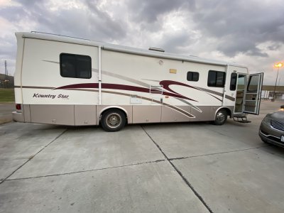

Hello,
We are new RV owners. We should have read through the posts first before buying, however in trusting our gut and God, we bought a 2000 NewMar class A. Haven’t drove it yet. It’s been stored while not in use in a cave. As newbies what do we need to make certain is looked at before inspections. We need all the tips we can get.
Thanks for your thoughts.
