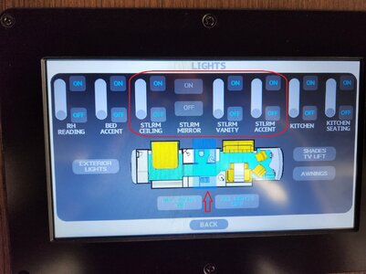

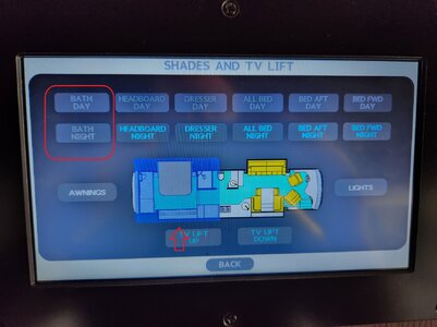

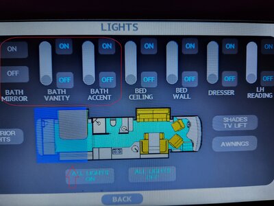

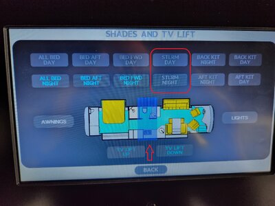

I've been trying to get a couple of SilverLeaf issues resolved regarding my lights and my shades on my 2023 Newmar New Aire. Long story short the main SilverLeaf panel acts like it only knows about floorplans with rear bathrooms and mid coach toilet stalls.
After calling Newmar (who had me call SilverLeaf) I worked out a couple of issues (which I've shared on this forum). However, after months of back and forth I still had the issue with the panel (and the System Control mobile app) not displaying the correct controls for the mid bath. I took my vehicle into Bish's for warranty work and brought the issue up to them. On my ticket, Newmar's response to Bish's service techs was (I've shortened): “…talked to Aaron from engineering and said that this was a one year thing as most customers complained about this issue. He also said that 90 percent of the coaches during this year had rear baths or two bathrooms. There is nothing they can do”.

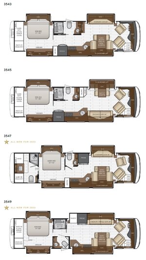

So, is Newmar’s response that the only floor plan that the SilverLeaf is set up properly for light and shade controls is the New Aire 3547 as it is the only New Air floor plan with a mid bathroom stall and rear full bathroom? The other 3 floorplans (3543, 3545, and 3549) are all mid bathroom only floorplans (no rear bath as the bedroom is in the rear). Is he claiming 90% of the New Aires that made and sold in 2023 were of this 3547 dual bath floor plan? I’m also scratching my head if only 10% bought the other floor plans, like myself, then how does that mean “most customers complained about this issue.”
I must say that I am very disappointed with Newmar’s response. This doesn’t align with “When you know the difference” motto. To have to click on your back bedroom to interact with the mid bath’s lights and shades doesn’t make any sense. To click on the mid bath on the SilverLeaf control and have controls pop up that do nothing makes no sense. Is Newmar ignoring the New Aire line of coaches (with the exception of the 3547) and trying to save time and money by reusing configurations for their other larger coach models that do have mid stalls and rear full baths? For being part of their “luxury lineup” I am quite disappointed in their lack of caring about the customer experience.

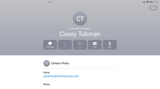

Incase you don’t already have his contact.
