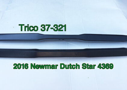

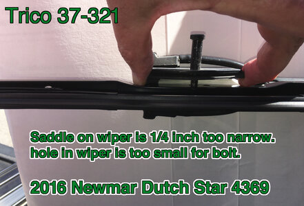

Neal, I have the same problem since new. I am considering shorter wiper blades. The existing 36 inch blades cover areas of the windshield that is out of my field of view near the top. Thinking of trying 28 to 30 inch blades.
CAUTION: Stay with 36-inch blades. I thought I would replace our wipers with 32" blades thinking it would be less work for the wiper motors and linkage—especially in the snow.
It did not work. I purchased a Trico 32 inch blade (67-321). The saddle is only ½ inch wide. It is a full ¼ too narrow.

Look at post #21. I loosened the self locking nut on the wiper blade and it works so much better.
