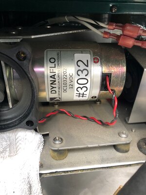

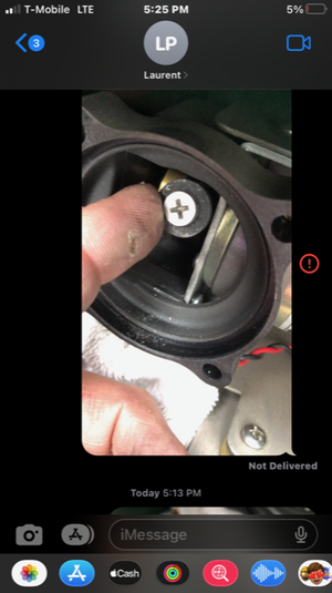

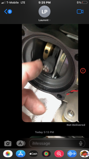

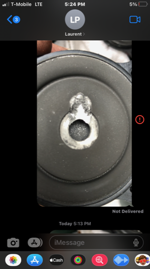

You are correct. The startup noise comes from the compressor. I removed the four cover screws and it appears the compressor piston busted through the diaphragm. Looks like the screw was hitting the diaphragm and wore a dent.

The fault occurred in the Oasis compressor not the vacuum pump.
