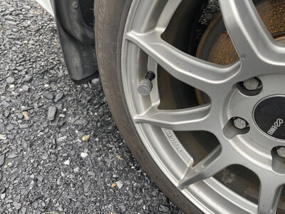

On the VW the OEM TPMS system does not use sensors. The VW system uses differential wheel speed to sense low tire pressure. Unfortunately I have had many flat tires on this vehicle and the TPMS system works flawlessly.
On the RV I use the EEZ TPMS system. EEZ uses screw on tire sensors. So the Passat has an OEM system when driving the vehicle and screw on sensors for the EEZ TPMS when towing. wheelsensor.jpg
