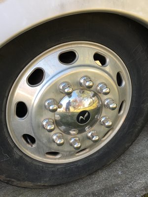

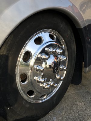

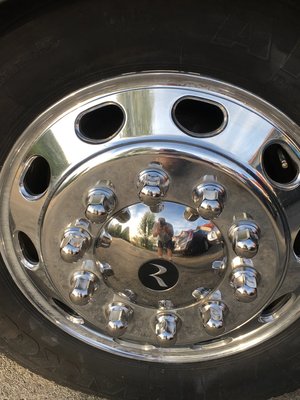

Last year I polished the aluminum wheels on my RV. Compared to what they DID look like the results were amazing although still not quite as good as I wanted them to look. They didn't look new again that's for sure. Well, here we are a year later and my wheels are dull and lifeless again. What I did last year was a LOT of work!! I really don't want to go through that again if the shine isn't going to last very long.
Have any of you polished your own wheels and were happy with the results? What products did you use? How did you keep them shiny?
I used a cordless drill and a Meguires Power Ball. The rubbing compound I used was https://www.amazon.com/gp/product/B075T36GHW/?tag=rvf01-20. After the compounding was done I used 3M Polishing Compound for the shine.
