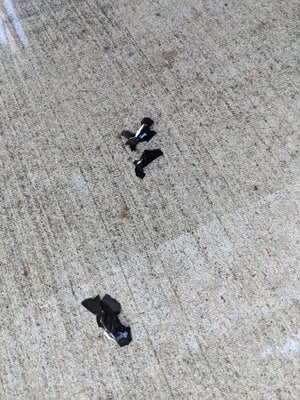

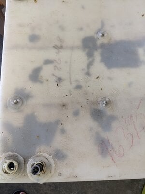

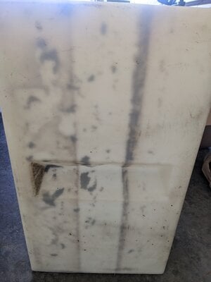

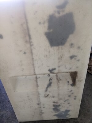

BLUF: How do I thoroughly clean the black chunks out of my potable water tank?
I've recently started looking at the potable water tank and noticed that it looked like it had some black scaling on the inside.
I filled the tank put a cup of bleach, let it sit for several days, drained it down to about half, road it around for 30 min or so drained it, several chunks of the black substance came out, still see a good bit on the walls , took a larger clear hose sprayed water on the inside, used it to drain larger chunks.
When you touch the chunks that come out the dissolve.

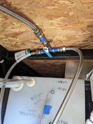

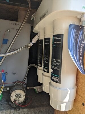

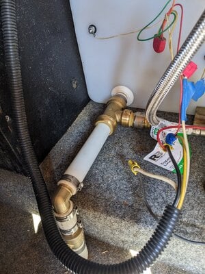

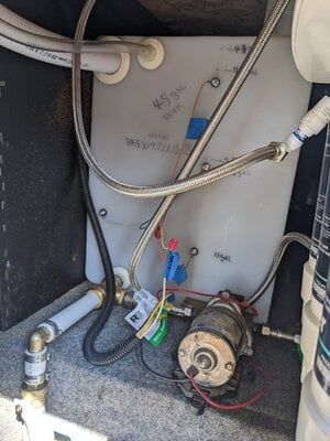

New Install complete, combined the drain and pump intake line, increased the size from 1/2 to 1". Added a cutoff to the hose intake as a backup to the check valve.. added a three canister water filter to cover both the tank and external hookup.
