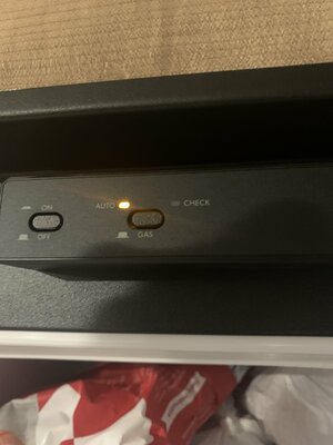

Problem with my fridge
It should work when plugged into 115 and propane is selected unless auto is left on. It should try to light 3 times and then lock the board out, requiring it to be reset. It will always default to electric when it is available. You should not have to unplug it. Good that it fired so you know it worked, now to find the problem with the 12v side that is not telling the board to use propane. The system uses 12vdc to work the controls, 115 ac only heats the elements.
HMMMM...... Where to start I wonder.
I miss spoke before it should work if gas is selected. I used that when plugged into a 30 amp or less to reduce the electrical load.
Bill
Most likely it is in the setting at what they call the eye brow or board. It is possible something is not right down on the board in the back, but most likely it is in the control board or eye brow at the front of the fridge.
Where are you located, do you have a multimeter, and does it have the clamp on amp function?
