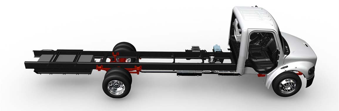

PDM issue?
In the last few years freightliner has had recalls and issues around their PDM module which causes issues with the left tail lights (among other issues)
