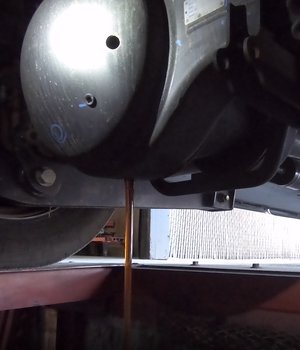

Agreed, your description of routine service makes sense. Luckily the Dana Spicer Diff in the Canyon Star is a "Front Loader" like a Ford 9" but with a drain plug. Designed to have the fluid drained without opening the unit or breaking any seals.
