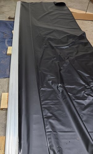

The slide toppers were getting really ratty. Torn, dirty, perforated. So, time for new ones. Amazon had a good price for bulk material. Bought two rolls. Pulled the old toppers off and powerwashed the RV, and the aluminum slide protectors to clean it all up.
Opened up the box and cut to length with a drywall right angle and a sharp utility blade.
Started to feed the cord into the slots...oh crap...the cord is slightly too large diameter. Upon research...mine are an older, smaller diameter cord. And I already cut the bulk fabric to length so can't return it.

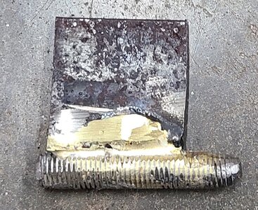

Hmmm, the parts are all extruded aluminum that the cord slides into...what if that was stretched out a bit. So, I fabricated a "Fid" out of a piece of threaded rod. Ground the tip down a bit to fit into the extrusion channel. Then, brazed a scrap piece of metal to hold onto the fid and to hammer. Worked pretty slick. I banged it all of the way down the length of the aluminum and widened up the channel just a bit.

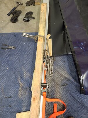

Then, I was able to get the cord into the new channel...but it was really tight. So, crafted a way to pull the cord / topper down the channel. Clamped some wood to act as long "pliers" to get lots of traction on the fabric without damaging it. Then, used a ratchet strap to pull the fabric. With so much length, there was a fair amount of friction. So much so, that the aluminum started to bow with the pulls. So, clamped a 2x4 down the length to make it more rigid.
Put some wiring water soluble lubricant on the cord to aid.
After about 10 minutes, the fabric was down the length are ready to put back on the RV. Thankfully the channel on the RV was the proper size so the fabric slid in nice and easy. I retorqued the topper windup spring to ensure good tension. Wound up nice and smooth and flat when the slide was pulled in.

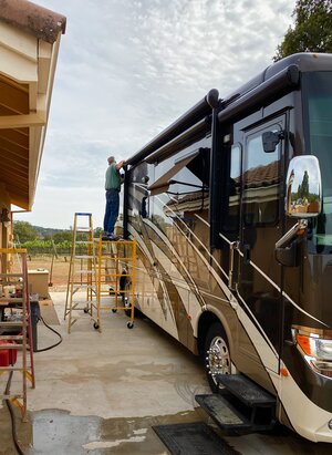

Putting the topper back on might need two people, or some good skills or some good stands to hold the free end while you feed the topper back into it's channel on the RV.
They made the R&R look like a two person job but from your description, I guess it can be handled by one, correct?
Depending on the length of the topper, maybe…
We had our FWS topper taken off while at the Mothership to accommodate some of the paint correction - five techs put it back on and they were working from scaffolding.
Older gentleman at our place in Florida last winter tried to do one of his by himself. Of course the slide was out (smaller bedroom slide) and when he loosened things the spring kicked in and about took him out.
I think a smaller one could be done by one person as long as the slide is in.
Personally I’d find at least one helper if I were doing one.

I did the short bedroom slide topper by myself. Step ladder mid span of the topper. A bit awkward. The kitchen larger slide, I had my son hold the free end. I had the slide Out and was able to walk on the roof of it to guide / pull the fabric forward down the channel. My son was on a step ladder.
5 techs? yowsa. I guess that's why they charge so much....that's way overkill. I can see three for a Full Wall Slide sized topper, the third to support mid span.
If I was by myself, I would have parked my man lift cage parallel to the RV side and put the topper on the railing of the cage to support the length. But faster to get my son to come to the aid.
If you didn't have a platform tall enough, I guess you could sling a rope across the width of the RV and loosely secure the end of the topper from falling with that rig. Would need a few trips up / down the ladder to reposition things as you progress getting the topper into it's groove.
The Spring: I had to unscrew the end cap to expose the slot to feed the fabric into it's channel. I put a long screwdriver into it's hole to keep it from unwinding. It has some torque so one has to be careful. Not quite as risky as a garage door spring, but same concept.
I had leftover topper material from the bedroom slide roll. Plan is to shorten the fabric length and use them for the window awnings so all match. But I have to find my sewing machine and get that setup. Another article for another day.
When I replaced the full wall topper, it was a 3 man job. 1 on the ground feeding it to 1 on a ladder threading it into the channel and I was on top of the extended slide pulling it.
