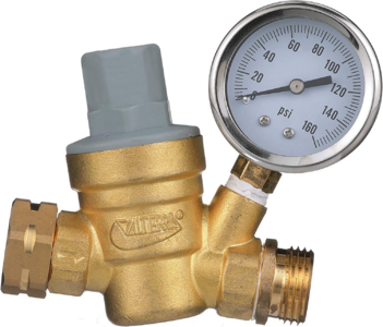

I've been using adjustable water pressure regulators since I started RVing in 2017. I've been through probably a half dozen as they seem to not be "adjustable" and are poor quality. For example today I know the spigot is high pressure but the regulator is showing 20 psi. I have a water pressure tester to put on the spigot but didn't use it, that would require walking all the way around to the pegboard bay :)

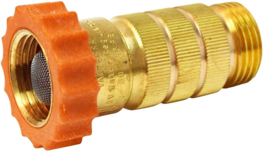

I went to Amazon to put a new Valterra adjustable regulator in my cart and stumbled upon the fixed flow rate version. I've known of these but thought they were fixed at around 40 psi. Now I see there are multiple versions such as one for 50-55 psi and ones for lower psi ratings. As my KOA is right next to a camping world I figured I'd stop in there and take a look at what they had. They had the two items in my Amazon cart so I figured I'd pick up the fixed flow rate one that's 50-55 psi as that's the pressure I like to run.
fixed-flow.png​
Also of note is I put my water pressure regulator behind the water reel. I believe there is pressure lost from the spigot to the RV so setting something like 50 psi at the spigot is not going to be 50 psi inside the coach.
So far I am pleased with the fixed rate water pressure regulator. The results within the coach are as expected.
Valterra adjustable regulator:
Valterra fixed flow 50-55 psi:
Valterra fixed flow 40-50 psi:

The adjustable Valterra looks like the one we have. No complaints with it so far. Have to get my wife to turn on a tap in the trailer then adjust to get a flowing pressure of 50 psi as the static pressure from the tap is fixed. I put mine right off the tap so it protects all my stuff.

As a follow up several months after installing a fixed pressure (55 psi) water pressure regulator, four thumbs up!! This is definitely the way to go, the water pressure has been perfect at all places that can supply decent water pressure. Not having something to fiddle with is also a good thing. After switching to this it's also apparent to me that if you have an adjustable water pressure regulator, it should be set ONCE and never touched again. Once you establish your desired water pressure such as 55 psi it doesn't matter if your source is over your set value then your set pressure will always be used. Having to adjust a water pressure regulator at any and every campground is incorrect. Set your pressure when you are lucky to have a source pressure above your set point and then it should never need to be touched again which I don't think people realize. Water pressure regulators are not something that need adjustment. Once set it's set.
I also have an adjustable one like in the OP's first pic. Piece of crap as far as I'm concerned. Mine will not stay at the adjusted flow; constantly fluctuating. I've tested it at various locations. After buying, I immediately went back to the fixed rate one. Works perfectly and fairly cheap. Set at 40lbs. as instructed by somebody I can't remember. :unsure: I'm really surprised at the one who set at 60. Maybe newer RVs w/pex piping or something?
