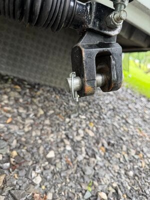

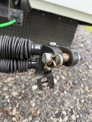

The last trip we were on I was getting my flat tow vehicle hooked up. I went through my routine and installed the connecting pin that connects the tow bar to the vehicle. I’ve always heard to install them from the inboard out. Then install the safety pin. I did that, did my lights and break checks and we were good to go.
I drove about 200 miles before I stopped for a break at a rest area. When ready to head out I did a walk around and lo and behold I found a connecting pin missing the safety pin. I couldn’t believe the connecting pin never came out. It was fully inserted. Luckily I had a pin that would work. I’m not going to use the pins with the rounds rings that clip into place.
Oh btw, I found the fallen pin. It was laying on the running board in some mud. My tire must of kicked it up. The spring clip is what I’m using now in the pic on the left.

I was taught to insert the pins from the driver's side so there's more chance of them staying if you lose the clip because roads are crowned.

I was told that when applying brakes the tow bar wants to spread or open up pushing the pins outward. I’m not sure what is really true, but the fact my pin stayed fully seated, I’ll stay with what I’m doing. 😁
I did have a pin break going down the road and the arm disconnected from the truck. We were able to get stopped without damage but it was a scary moment. I purchased a new set of pins and now carry an extra set. These pins should be changed out occasionally

I had that same clip fall out of mine while towing. I had put the pin on the outside where the safety cables connect to the bracket. The cable must have popped the clip, the pin worked out and I felt a heavy drag. Looking in review camera I saw the toad towing off to the right. I had very little shoulder but managed to get over and stop. I had a surge brakes system and the brake cable applied toad brakes and let me know something was wrong. I disconnect the toad and wife drove it the last 50 miles to our destination. Devine intervention kept us from a serious accident.
Now I always put the pin, clip on the inside of the bracket, away from the chain connection.
