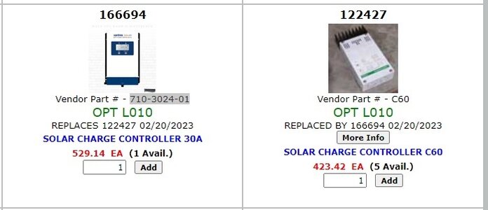

Because you asked @Neal my system is based on 60 amp controllers.
Why you ask??
A 60 amp controller will handle 720 watts of panel at 12v, 1440w at 24v. This means I have back-up if failure occurs. I know that is my sailor mentality, but just the same! Sometimes controllers are a week or more away.
But there is a better reason to use smaller!!! Because he who dies with the most toys wins!!! OK, just kidding
. Shading just one cell on a panel kills the power of the whole panel. Well I have more bad news. The complete system can be compromised. Imagine back feeding one cell with your entire 1800 watts!!!
So where a possibility of Shading is present, I have split the power between several controllers. I have 4 controllers in my system.
More directly because Shading is such a big issue on a RV, many smaller controllers are the way to go!!! And yes 100 amp Controllers would do the job, smaller will also do the job at a lower overall cost.
