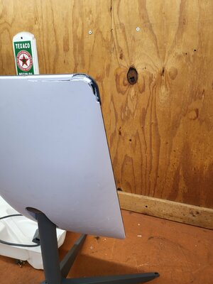

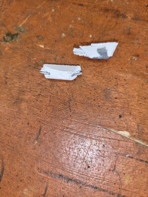

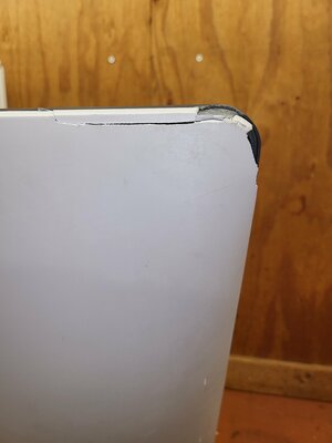

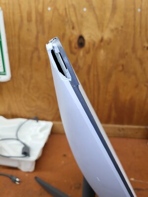

Well crap, we were loading up about a week ago and I had put my new Starlink dishy on the table as I rolled up the cord. As I straightened out the cord I inadvertently pulled it off the table, it did a perfect transition to a dive and landed on the top right corner breaking it. I ran over and picked it up as I cussed myself and questioned my intellect.
In the end I packed everything and brought it home. I sent Starlink a support request 10 days ago asking a few $ questions trying to decide if I should try to repair or replace this with either the same dish or an in-motion style.
I'm going to follow-up again today with Starlink and see if I can get some answers. Has anyone figured out how to get them to respond?

Welcome to the club. I put white gorilla tape over mine to keep it sealed up and it works fine. SL wanted $500 for a new one, not needed and at some point a newer better model will come out and I'll consider it then. So if it works, put some tape on it and move on :)

I tried the app and that worked, took just over 2 weeks to get a to bad but you'll need buy and entire kit because they don't sell the dish alone.
So I did what Neal suggested and used silicone sealer and a couple of days later Eternabond Tape. Belt and suspenders.

Ha Ha Yes, I did tip it and make sure it didn't make any noise. I've seen a couple of YouTube videos where a guy cuts his open to disable and remove the mast then mount it in a stationary position. I think the only moving part is in the mast to tilt and rotate.
I tested it here at the house after everything setup and it worked wonderfully.
