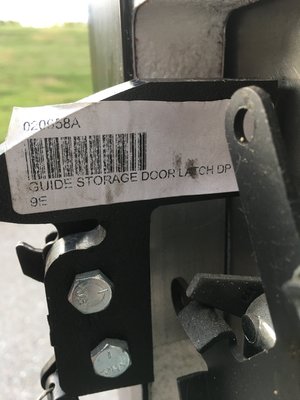

Newmar Parts, $63.00 and change, should be here by Friday. Latch has some redesign, expensive part is the nylon support/guide thing. There is a left and right side part number. I will attach the document from Newmar. Very excellent service. Lots of supply on this part.

Received Part today. Going to install tomorrow, will try to remember to take pictures of any gotchas, so you have a record. Does not look like rocket science. I never observed any tension on the cable for the lock, so not sure why it would ever come lose.
All - Finally had some time to spend on replacing this latch. But, I don't seem to have the correct sized star drive to losen the screws holding it to the door. Does anyone know the correct size so I can get it and get this done. Mine is slightly to small, or way to big. Are their metric Sized ones? Or are these not star drive headed screws? Any info would be appreciated.

If you have a Newmar: Get your 7/16 wrench or socket, and loosen the two bolts holding the U part attached to the outside door frame. Tap it outward about 1/8” at the time, until the door latches easier. Than tighten the bolts.

@Neal got it right! They are not “star-drive” screws, (though they look like they are) but, instead, are “#2 double-square drive.” None of the star-drive bits will fit them very well. The double-square fits perfectly, at least in our coach. A standard #2 square-drive bit will also for them properly.
I checked Newmar parts maybe four or five months ago.
The black plastic guide was $48.46. However, it is very poorly designed. It is as if they wanted it to break easily.

No idea for a different source for the plastic guides. $48.46 each for poorly designed versions can get expensive quickly. I did see someone on iRV2.com who made replacements out of aluminum. However, he hand made one and had his son use a milling machine to replicate that one.
The plasctic part according to newmar is not their part. They buy it from a person who has patent on it, and he sets price. That is why it is so expensive. We could band together and reverse engineer it, and then have it made out of glass filled nylon, which would strengthen it considerable, that would or might make it stronger, but it might be more brittle. It's been redesigned a bit according to the parts person I talked to, I don't see any difference. I was not aware of the latches being from another place. If I have another issue, I will order some extras. If I had band saw, could make template out of wood or something and then cut them out of pieces of plastic of some type. Lot of work for small part which might or might fail again. I guess a survey of "latch failures" might be in order to see what numbers we are talking about here. The plastic thing looks to have some machining on it, I am not sure if it's injected molded or not, I will inspect for parting line and other signs it was. They might be machined in jig by the hundreds or so.
