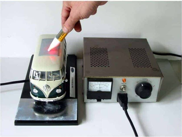

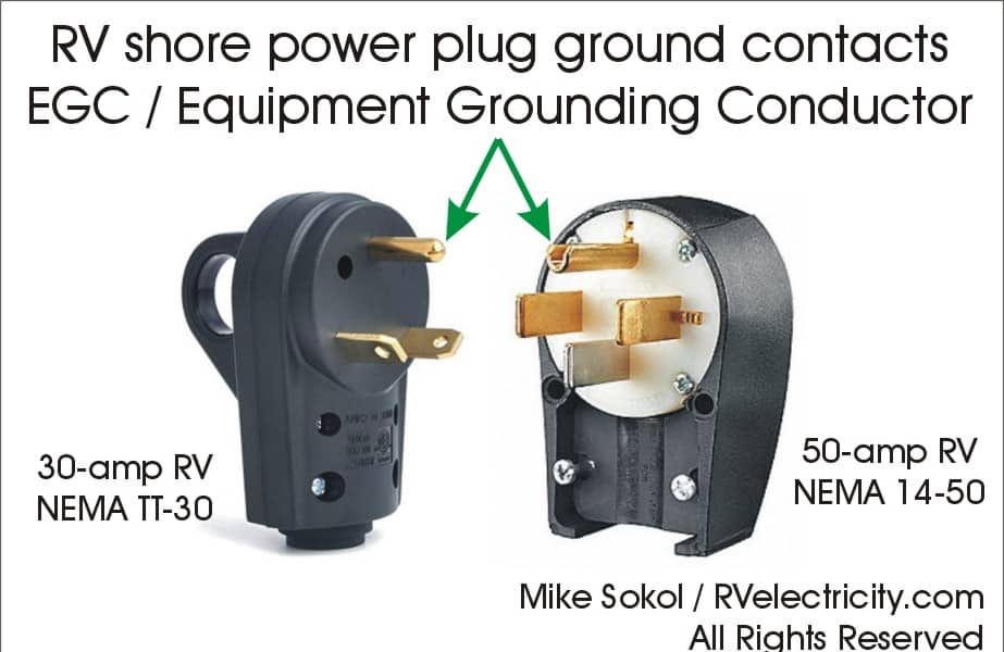

This is called "Hot Skin". It is dangerous. My husband had to take a fellow camper to the hospital over a "little tingle" that he had been experiencing for a few rainy days. It was the shock that knocked him off his feet that put him in the hospital (which was less than a mile from the campground we were in). Seems someone rewired the pedestal in his site. He kept saying it was just a little tingle, it wasn't anything to worry about. PLEASE read

Wow! Thank you for the detailed response. Pretty much covers what Larry the electrician said when he came by this morning. Currently the RV is unplugged from shore power. A proper TT 30a 120v outlet will be installed this coming Monday. Pretty sure that will take care of the problem.
Our home was built in the 60's and has been through remodels and additions. This plug and few others are original to the house. Looks like another item on the honey do list.
