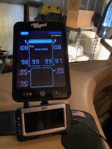

Here is a pic of the new Tire Minder. The NS on the bottom is because I don't have my jeep hooked up.
