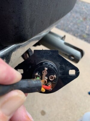

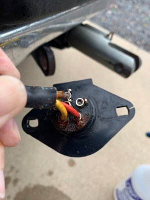

From your picture of your connector, it appears you have:It was really corroded
I'm glad to see you added "apply solder to the ends of the wire". It is such an easy way to make sure there are no "stragglers ( threads of wire that don't go into the socket), less chance of corrosion and better contact with the socket.. I always apply contact grease as well. Good advice. thanks for sharing.From your picture of your connector, it appears you have:
Tail / marker lights
Brake / right turn
Brake / left turn
Ground
I am guessing your toad brakes are in the hitch.
Take a picture and/or make a diagram. Remove the wires. Cut your wires back to shiny copper, or clean them with fine sand paper or steel wool. Be careful not to get steel wool fragments in the contacts. Solder the ends of the wires and use electrical contact grease to install the wires back into the correct holes. Consider buying a better grade metal connector assembly from a trailer dealer. Wrap the wire assembly with good electrical tape, preferably 3M. Do not over wrap so the wires will not go back in the socket.
I suspect your poor contacts have made other contact areas to become compromised. Now you have a start and you did not pay Freightliner to search for the problem. You can use electrical contact grease on the light socket connections if you like.
Darrel, Thank you for the clarification to our members. I know what I meant and so did you. The procedure is tinning the ends of the wires. The little screws are easy to strip out. Be careful not to over tighten."apply solder to the ends of the wire"
