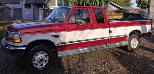

I have a f250 ps 1996. It has 8 ft box. It also has a 1ft wide fuel tank against the cab leaving me 7ft. Do I need to take tank out? (not wanting to) the camper is a 11ft

You're kidding right? This truck has pulled a 40ft triple axle Royals International 5th wheel. 19k pounds empty. I take that comment as someone that doesn't know what a OBS Ford 7.3 Powerstroke can do. Plz educate. Simple question was, will it fit. 8ft box is a 8ft box is a 8ft box. Sorry I asked!!

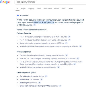

Here are the load and tow capacities for a 1996 F250
