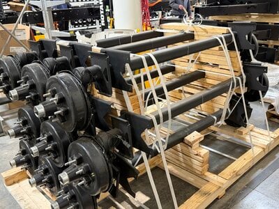

@josephpRV maybe I missed it. Is your build complete in station two and just waiting to move into station three, or are they still completing work in station two for you?
VIN 15 is still sitting between Stations 1 and 2. Stations 1, 2, and 3 are all occupied with me at 1.5 … or close to 2!
I didn’t cover it this week as nothing obvious had changed, and it’s still waiting axle assembly and CV shafts before officially being ready for Station 2.
More broadly my observation is that supply chain is still maturing and probably evolving rapidly as the bill of materials continues to improve with either better products or direct feedback from units in the field.
The upside of a startup is they’re agile, the downside is that supply chains like discipline and are inflexible to rapid change. So I suspect some bottlenecks are because of that.
I may dive into that a bit with Hayley next week.
I am keeping an eye on VIN 17 … as far as I know it hasn’t hit the line yet.
