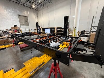

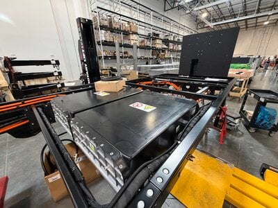

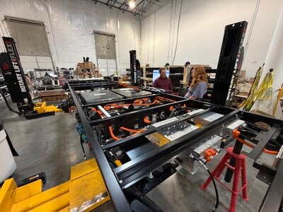

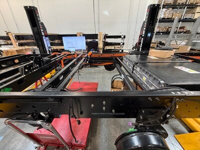

VIN 15 remains in Station 1, but the platform is starting to look substantially more complete than last week. Since my previous visit they’ve installed:
• Front axle
• Both HV batteries
• HV harnessing
• Coolant pumps
• BMU and onboard charger
• Tongue-box electrical center
• HVAC condenser and heat exchanger
There’s significantly more structural tubing than I expected. Zach mentioned this last week, but it really has to be seen in person to appreciate the scale. The photos and video give a better sense of it.

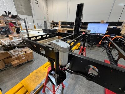

Hayley mentioned last week that Station 2 looks simple but takes time. After seeing it, that tracks. Two major steps happen here:
  1. The bonded structural floor goes in
  2. The four canopy actuators are installed and aligned
The floor install itself is straightforward. The actuator alignment is not. Ben Robbins walked me through the validation work they do on the actuator assemblies. For anyone interested in a deeper cut on the actuators, the companion video has it all.
For those who can’t watch, here were my key takeaways:
  • The actuator and mounting structure are (of course) extremely rigid
  • The assemblies become even stiffer once the tub walls are added and bonded
  • In travel mode, the canopy load sits on bumper stops, not directly on the actuators
  • The customer experience with an actuator cycle is about 2 minutes up and 2 minutes down
  • There is a manual fallback if ever needed
I tried unsuccessfully – and with permission - to shake the actuator assembly while it was mounted. It didn’t move. That went a long way to answering my durability concerns, particularly after a dirt washboard-road type scenario pretty quickly.

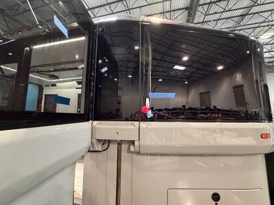

  • VIN 8 - Yellowbird was heading out for road testing while I was there. The rear light bars look even better in motion than in photos.

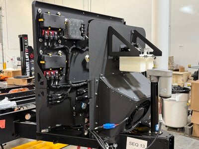

This post is a bit longer than usual because we’re digging into the hitch sensor in some depth. Along with the actuator system, it’s one of the two defining Lightship technologies that really set this trailer apart from anything else on the market, so it naturally attracts more curiosity and skepticism and deserves a closer look.
Quick summary
VIN 15 is still wrapping up Station 1 – Underbody, with Station 2 – Tub Frame and Actuator Calibration up next.
This week we did a deep dive into:
  • Station 3 – Interior assembly walkthrough with Hayley
  • Hitch sensor and TrekDrive control logic walkthrough with Greg (software engineer)
Throughout Station 3 Hayley emphasized automotive-grade standards, durability, and functionality as the guiding principles behind every fixture and material decision. After seeing the components in person, that claim is hard to dispute.

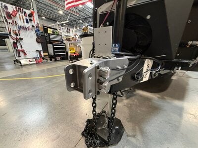

Greg walked me through the hitch sensor system feeding real-time force inputs to TrekDrive so the trailer and tow vehicle act as a coordinated unit, along with several fail-safe behaviors that forum and video commentators have questioned.
The sensor reflects a familiar engineering pattern at Lightship. Apparent simplicity backed by substantial hidden complexity. The implementation is clean and elegant but clearly the result of significant development effort. Sessions like this continue to reinforce my confidence in the purchase decision.

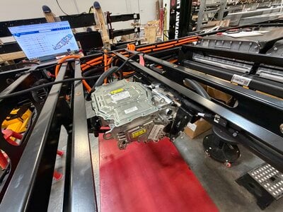

VIN 15 remains in Station 1 as platform integration continues. Since last week, the team has:
  • Installed rear stabilizer jacks

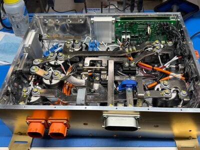

  • Installed the HV PDU (Power Distribution Unit)
  • Continued routing HV, LV, coolant, and water lines throughout the vehicle
  • Installed the TrekDrive motor unit (motor, differential, and inverter integrated into a single assembly)
  • Installed the pump box, including water pump and accumulator, to pressurize and distribute water
Note, the HV PDU is a work of art. These are custom designed in-house and individually assembled by Steve (picture attached). Their job is to safely interrupt hundreds of amps at lethal voltages without internal arcing or contact welding. They are intentionally overbuilt as you’ll see from the photos.

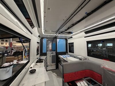

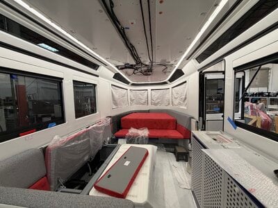

Hayley walked us through the interior build out this week.
Interior Design Philosophy:
Lightship uses automotive-grade materials and construction rather than scaled-down residential RV components. Many suppliers come from automotive or adjacent industrial sectors rather than traditional RV catalogs.
Because the canopy raises and lowers, fixtures anchor directly into the tub walls and floor for rigidity. The wheel wells are integrated into concealed structures supporting the aerodynamic architecture. My patented
informal shake test showed the structure moving as a unit rather than individual components flexing independently.
Section-by-Section Interior Observations
Interior Architecture
  • Automotive-grade components throughout (not residential RV fixtures)
  • Fixtures anchored directly to tub walls/floor due to lifting canopy
  • Wheel wells integrated into cabinetry and utility spaces
  • Bonded wall interfaces increase structural stiffness
  • Interior behaves as a single rigid structure under load
Storage Console
  • Four perforated aluminum cabinets sized for Lightship adventure bags
Galley
  • Sheet-metal cabinet interiors (no flex-prone panels)
  • Sink module: 1 cabinet + 3 drawers
  • Prep module: microwave/convection/air-fryer, dishwasher, storage
Bathroom
  • Wet-bath layout draining to shower zone
  • Toilet positioned directly over black tank
  • Partition designed for canopy lift loads
Dinette / Bench
  • Electrically adjustable dual-pedestal table converts to double bed
  • Bench conceals water heater and utility panels with service access
Primary Bed
  • Dual-use platform supporting both sleeping and daytime cabin utility
  • Enables continuous access to under-bed gearage storage without converting the space
  • Storage also integrated within adjacent seating zones
  • Molded perimeter tray functions as a stable nightstand surface
  • Integrated power access and electronics catch areas
  • Converts a traditionally single-purpose RV footprint into an active 16-hour living surface rather than an 8-hour sleeping zone — I originally read this as a constraint; I now think it’s one of the smarter innovations in the layout
Seating + HVAC
  • Seating doubles as concealed duct routing
  • Direct airflow across ~70% of cabin volume
  • Indirect coverage to kitchen and bath

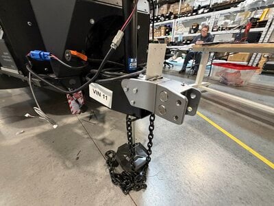

Station 3 – Bonus Deep Dive – The Hitch Sensor
TrekDrive reacts to force measured at the hitch rather than assumptions about tow-vehicle behavior. Key observations:
  • Measures axial load and tongue weight directly at the hitch using dual force pins
  • Maintains near-zero perceived tow load during normal operation
  • Activates regen assist automatically when the trailer pushes into the vehicle during deceleration
  • Trailer brakes engage only when the tow vehicle brakes
  • Operates as a passive trailer below ~15 mph; above that speed it actively offsets drag
Failsafe - Lightship defaults to standard trailer behavior in any abnormal or fault detection scenario.

  • VIN 8 – Yellowbird must be getting close to delivery. It was covered in rain from a test drive.
  • VIN 9 – Blue Elephant was sitting behind Yellowbird.

Attached are updated Station 1 photos for VIN 15, along with several photos of the hitch sensor unit. This week’s video (linked below) includes a deeper walkthrough of the hitch sensor and TrekDrive integration along with the Station 3 interior session with Hayley for anyone who wants to see the hardware up close.

Great report with some new information. The Power Distribution Unit has been a "black box" for me. LightShip has been rightly very secretive about some of the in-house developed devices in the LightShip. But now that the LightShip is in the field it is only a mater of time before some competitor gets a hold of a LightShip and begins to reverse engineer the the unique components.
There is a lot of new, innovative technology in the LightShip that the average RV owner is not going to understand or appreciate, but more importantly without seeing this technology they cannot understand the value proposition inherent in LightShip.
The Power Distribution unit and the devices that support TrekDrive are two areas of technology that is new to world for the RV market. I am glad this reveal of the LightShip technology is now taking place. It is an important step for future buyers of the LightShip to understand the value proposition.
This device looks like it came out of a SpaceX rocket, not an RV.
+1
The PDU is a work of art. Zach told me that one of the investors who is familiar with the technology commented that a dedicated PDU firm would be hard pressed to match the quality.
I go into these walk-throughs every week expecting to see typical startup problems. Of course their processes are evolving and they continue to evolve weekly. One area where I keep walking away more than impressed is the product.
Their dedication to automotive standards and recognition that the brand is being built in these first few hundred units really shows.
Canopy next week … I’ll make sure to get you some close ups of the old vs. new structures.
