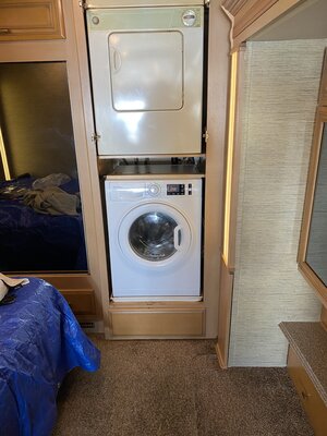

I have a2015 Ventana with the dreaded Whirlpool washer. Have spent more money on repairing this machine to no avail, than I care to disclose. Have bought a Splendide machine to replace it. Any help in how to remove the old machine will be appreciated. The dryer is mounted on a shelf so it shouldn't have to be removed to get the washer out. Wife is fed up with beating clothes on rock at the creek. Any help is greatly appreciated.
I’m assuming your asking how to remove it from the cabinet , there should be a thin board that pinches the top of the washing machine that spans side to side and held in with a screw on both sides. You will need to remove the board. Once removed you will be able to lift the washer up. It also may be necessary to remove the cabinet door. Pictures of the installation would be helpful to further assist.
Agree with @Stuart W . Once you remove the hold down board and disconnect electric plug and water lines, you can lift it out. I hired a mobile tech to assist me because of a bad back. Once we got it out we rolled it on a hand cart out the door, brought the new one in, leveled it, installed, and reattached the doors.

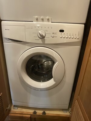

FWIW I have this Maytag in my 2016 (dealership install). Been a very good machine, but as stated above, I do small loads more often

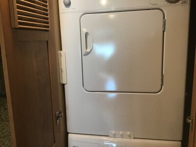

Also both machines would rock back and forth on their mounts enough when driving that the dryer knob contacted the back of the wood louvers in the cabinet door causing damage (repairable), so I installed a stop to prevent this ( second pic).
