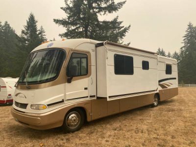

I just joined today! I have been an iRv2 member for a long time, but their focus seems to have shifted to newer/new $250k + RVs. I am renovating my 3rd RV right now, a 97 HR Vacationer. Thank You!
Well great! Glad to have you with us. Please start a build thread so we can follow the progress!

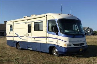

Thanks, this is what I suspected. At some point someone must have removed it and the related wiring.
Nice to meet someone with a similar rig!
