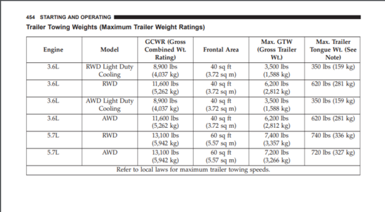

Unfortunately, the owners manual for the durango only mentions frontal area as a definition and does not indicate a maximum limit for towing.
That's odd, my 2017 manual has this. But the 2022 manual has much less info!

40 Sq ft is what I saw others mention for their older models. Given that nothing else in that chart is different for the AWD 3.6L, I'd assume the 40sqft is the same as well. If you look at frontal area of any non-popup trailer I think they'd all be eliminated.
