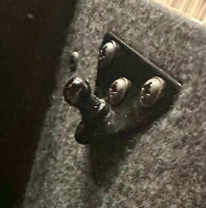

I installed correctly and nothing blocking; however, I paid more attention to the side of the strut that came off the ball and I noticed the forward metal plate seems to be curving off of the wood and that ball might be a little crooked. Could that cause it not to lower? I don't suppose bashing it down with my mallet would be a good idea, huh?

I really want to bash it. So I'm guessing this is the issue and will need to replace plate. Also guessing this is why the top part of strut popped the ball. I wonder what caused it to twist. Photo below:
While that is a little mangled and should be replaced, I would be really surprised if it was keeping the bed from going down. I can see it possibly being the reason the socket end pops off. on our bed, once you start pushing down, you have to hold it to keep from really slamming. You haven't put stronger struts than the OEM's have you? Not sure WTH you could have done to accomplish that.
