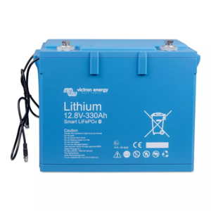

I wanted to see how much the Victron 330ah batteries weighed and noticed what other vendors were selling them for - $2200! Wow, that's an amazing price compared to the Battleborn GC3's I was considering which are 270ah batteries. I emailed Brian of the price difference in that I wanted to give him my business but I wasn't thrilled with throwing away $1100 per battery. I asked if he could match the price. He contacted his rep, the pricing had just dropped, he matched the price. Hallelujah! The plan is now set for 4 x Victron 330ah batteries, dual Victron Multiplus inverters, Smart BMS, Cerbo GX, vent fans controlled by the Cerbo GX to ventilate the battery bay, AGS module that allows Victron to control the generator with far more control the Magnum even allowed. I learned from Brian that mixing vendors is not ideal as things don't work well, I won't get into the specifics of that discussion.

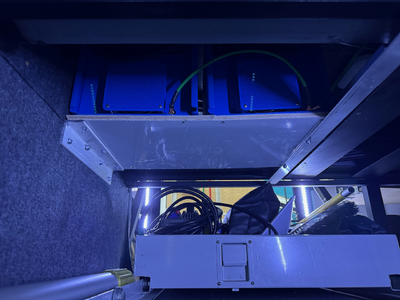

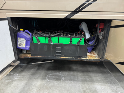

Day 1 was mainly demolition, removing all the old stuff out. My solar charger setup was all in the pass through bay on the wall and I wanted it all cleaned out and properly installed into the new sealed battery bay. They put temp batteries and inverter in place so I could stay in the coach in the evenings, so that was nice.
Day 2 was a little disappointing as at the end of day 1 they hyped the plan for day 2, then the morning of day 2 the same, and the day ran long so I expected major cool stuff to see but was let down. They simply paneled the bay using what they call FRP which is a white coated stiff board and also used spray foam behind the boards and also sealed the edges, etc.

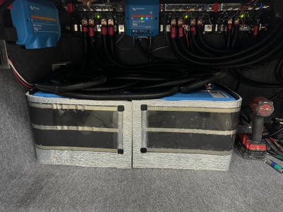

Towards the end of the job I had an idea to box in the batteries with FRP and carpet to make it look clean and also decided to add the heating pads as LiFePO4's won't charge below 32F. What I've been surprised with though is that batteries put off heat just by doing their battery thing and even in freezing nightly temps they've been around 60-70F. We have a temp sensor in the battery bay that shows me the temps on the VRM portal and can also alert me based on alarm rules, and my wet bay temp sensor I installed from the prior setup is also integrated which is nice. The temp sensor also controls the battery bay ventilation fans so as heat rises in the summer it will ventilate the bay automatically.
Custom heating pads

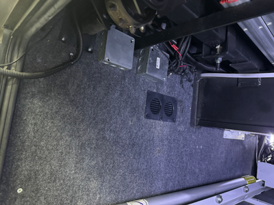

Cooling fans​
So we (they) boxed in the batteries with adhesive heating pads installed and also put two vent holes on the right side per my direction which came out nice. I decided to go with a dual inverter setup which allows the coach to remain energized to 50A at all times. There is nothing in the coach I cannot run on batteries as if it was on 50A shore power. Another amazing feature of these Victron Multiplus 3K 120V inverters is a feature called PowerAssist. If I'm connected to a shore power source of at least 7.5A then the system will augment shore power with battery power to allow the coach to add 25A to whatever is coming in. For example, if I'm on a 30A shore power connection, the coach will still operate at 50A as it will supplement 20A from the batteries. Way cool!

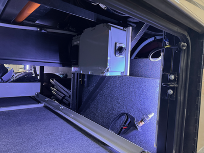

Dual Multiplus inverters
One nice feature I noticed on the Victron Multiplus inverters is they also serve as a UPS such as for computer equipment. As I bring my PC tower along I to date have had an APC BACK-UPS battery backup system I've had to use not only for surge protection but to keep the computer running when there is a power transfer such as from shore to battery. Magnum never handled this well and Victron says their inverters switch over so fast that computers will remain running. Sure enough I tested this out and it worked perfectly. Computer on, shore power, then went out and turned the breaker off and the computer was fine. No APC inline, so that is now out!
