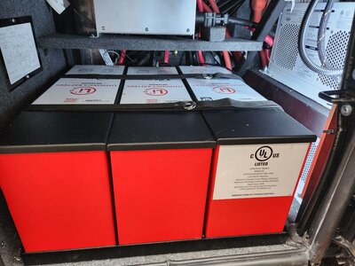

Take for example simply replacing FLA/AGM batteries with LifePO4 giving you a larger spectrum of usable battery and also faster recharge times such as from a GEN. This further negates the need for solar IMHO. Put the money towards a sufficient and correct LifePO4 install FIRST and go from there. Solar panels and solar controller are the cheap part of the setup. LifePO4 batteries first, other components secondary IMHO if I did it over again. I believe good batteries is all "most" here really need.

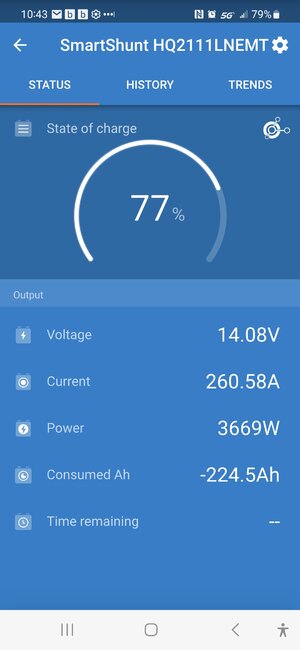

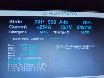

Edit: I'm curious of how fast a GEN can recharge a LifePO4 bank. Need to know the charge rate for LifePO4's and how long a GEN run would be required for recharge.
