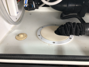

I got on the sani-con bandwagon in my RV exploration mission to learn about RV accessories with my first ever 2017 Newmar Ventana motorhome. A lot of mixed reviews on the sani-con from hose issues, smell issues from the hose, how to route it, pump inverted and they are hard to get as you have to "typically" buy from a dealer but if you contact thetford, there are ways to get it. Thetford recommended the Turbo 400S due to the smaller wet bay in my coach model and also I wanted a bayonet mounted option. Since installing the sani-con it's all I use, I have yet to use the 3 inch sewer hose since using sani-can as it's really nice to have an always connected hose. I don't have to deal with setup and break down of the sewer hose. I can open the wet bay door and extend to dump then stow or if I want to remain connected in a full hookup situation then I can drop it down through my additional dedicated wet bay hole.

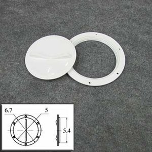

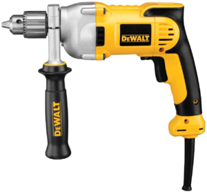

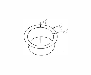

The wet bay floor is quite thick believe it or not with about 5 layers of stuff. I could not get through it with my cordless drill, I needed something powerful. So I bought a Dewalt 10A corded drill (awesome by the way) for the job and also a 5.75 inch bimetal hole saw. Get the parts from Newmar Parts for the wet bay port as you'll need the top white screw on cover and the under side black coupler. (parts 23815 and 49736). Test drill on a cardboard box to test the hole size and overall fit.

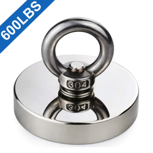

Wear protective gloves and eye wear of course, if the drill kicks it can injure you so you need to be very very very very careful! (got it??) FIRST and before I forget, supposedly there could be a metal cross beam below the wet bay. Drill a very small pilot hole first to probe for bad news. Usually my luck is to find these things out and take a trip to Newmar with my home made sandbox to put my head into and show up for a repair. But I listened to the master @Stuart S and learned to buy a very strong magnet and check for obstructions. Crisis averted. I got the hole drilled, smoke and all, whew, that was not easy but it worked and boy is it nice to have this port. This is placed per my sani-con install and alignment and it's so nice to feed the sani-con through without losing much if any overall length to the ground receptacle. I designed and 3D printed a small cover plate to keep the critters from using the sani-con hose as a ladder.

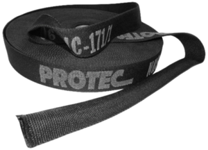

By the way, to protect the sani-con hose from gravel and pin hole potential I use a protec sleeve with rescue tape on each end to secure it.
