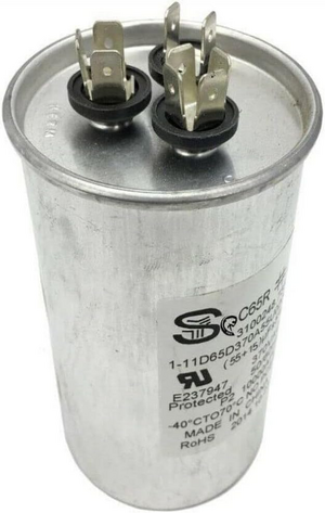

Discharged it 1200 times, also bought a discharge tool. I was unable to test mine with a multimeter. Just shows OL no matter what I do. I watched YT videos, either mine is truly dead or I can't figure out the fluke and it seems straight forward.
I wish I would have known to carry a spare one of these. How many people replaced complete air conditioner units instead of replacing this $80 part? If you don't have one, I suggest carrying a spare. I'm ordering two, one for spare.
Dometic 3314471.017 Capacitor

i would try to find 18k btu for replacement.....I would suggest try swapping capacitor from your good working AC.....could be the only problem
the capacitor will be behind a aluminum shield. my 15k dometic is a 55/15 dual capacitor. looking forward to front of coach with cover off ...be on right side near control board
$80 is way to much for a capacitor. I wish I could get that for my remaining stock. You have to set the Fluke to the correct setting. It is not ohms. It looks like and arrow pointing to a vertical line, sometimes curved and a straight line come out of the point where the arrow touches or nearly touches. Batteries must good in the multimeter.
There were cheaper options half the price but this one had 92 5-stars so I’ll take it. Cheaper than replacing the AC.
I did use the right setting. I’ll try putting fresh batteries in the fluke.
Ok, You have to hold it on there for a bit to give it the chance to put a charge into it and read it. 5 or 10 seconds.
