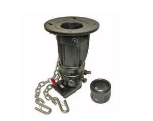

I haven't used one, but in other forums they seemed pretty good. I used a Goose neck adapter on my 5th wheel since my 2017 Titan XD came with a goose neck hitch from the factory. It is a little bit harder to connect to the trailer with a goose neck as I could not see the hitch. What I did was mark a center line on the tailgate and bed of the truck, then mounted a GoPro camera looking down on the trailer side of the hitch. Using the GoPro app on my phone or ipad I could backup and follow the center line. Once I was over the ball I stopped. Worked every time and did not need extra eyes. It looks like your adapter is much higher so you may not have the problem I did. AS far as towing goes, it did not feel much different they the regular pin type hitch. If you could I would go with one of the air ride hitch for the trailer. I had one of those on a previous trailer and it made a big difference.
