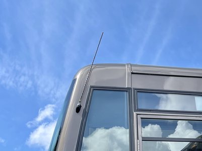

There are some CB options for No Ground Plane for RVs (NGP)... a NGP side mount FireStik Firefly kit has been developed for just this purpose.
A 3' Firestik Firefly model could be installed on the A pillar without much drama. The wire would be concealed behind the molding and dropped either below the dash or fed directly to a dash mounted radio.
The benefit of the FireFly Firestik is that is has a smaller cross section, less wind drag (easier on the mount), less wind noise, more flexible to accomodate the errant tree branch. Downside is that it is less efficient than the larger Firestik FS.
Or another option as AdbRahim has installed, an antenna on the rear ladder and run Coax up under the RV to the front. The real benefit for that work is a more efficient antenna design with a tuned counterpoise wire acting as a ground plane.
