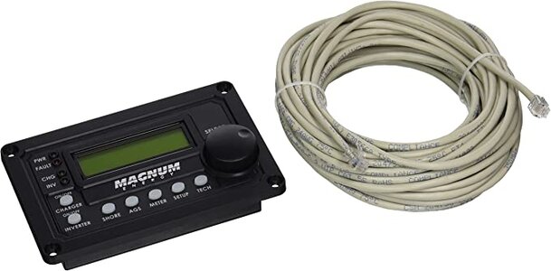

There should be a big black box filled with MFG User manuals. Look for the Control User Manual. Is it an RC 50 or some other Magnum controller? RC50 image below
I don't believe I have that device on my 2023 New Aire. Everything is apparently controlled through the Silverleaf system talking to the inverters for thinks like shedding and gen autostart.
