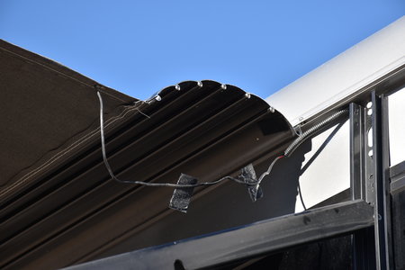

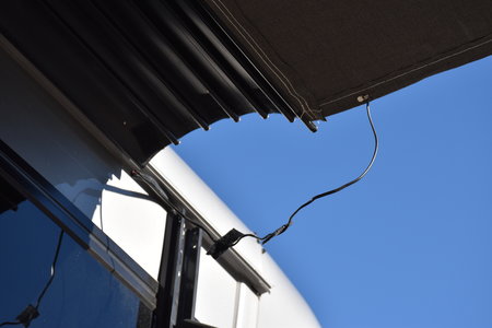

We just purchased a new Bay Star. It's nice but we have some issues. Low water pressure at the kitchen sink
and a loose wire on the awning. I have to watch the awning carefully when I extend or retract it. I tried to put the wire back
where it came loose on the plastic shield but it just comes right off. (they used velcro) The earliest service appointment is June.
Just wondering if anyone had the same issue and what the fix might be. One other important issue. We noticed that when
the drivers seat is lowered, it can crimp the wiring underneath and cause a short. Luckily I caught it in time and I'm skilled
with electrical.

I have the same issue with the led wire on the awning, 3M VHB tape seems to hold well vs the velcro. Still trying to find a permanent solution.

I was told at Newmar that the awning wire could not be addressed because they did not install the awning light. Well, who did? The dealer didn't. Go figure. I'll try
the 3 M tape...my velcro is still holding. LOL Please keep me posted. Overall we like the Newmar...just a few headaches. I guess that's normal.

I guess the awning wire is a Carefree issue their tech support is good so that may be the goto for this issue.
