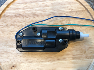

EDIT POST. I looked at TriMark website and they look like the attached photo. I think the info I got from Newmar might not be correct.

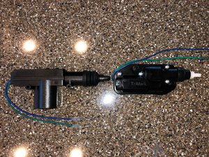

All you need is the actuator, it is reversible. On eBay it was approximately $20ea. You can see the two items I ordered, the 2nd item pictured had other nonsense I didn't need, it's a more complete kit for adding a lock. I did a quick search and there are not many options out there. I checked rvupgradestore.com and etrailer.com with no luck. Not sure if you can get them direct from trimark. As this is a non critical item i.e. you can still use your key to unlock and it will remain unlocked until you lock it I suggest at the price above only order when you need one. If you find cheaper ones elsewhere then get a few for spares.
Make sure if you're under warranty that you check this when you arrive at Newmar or your dealer for warranty items, do a final check of your doors. Again I'm 3 down in 2.5 years. It's cheap plastic and the tips that push/pull the rod sheer off.

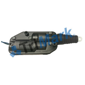

Is this the one we should be looking for?

I saw that, it has a weird protrusion coming off the side, not sure it will work. I need to dig out my spare to replace the broken one. I'll get a picture and post it once I find it. As I never lose anything in this small coach I should have that picture within 24 hours! :rolleyes:
My guess at the moment is NO - that one will not work. You really need the 550-0100 Compact Style
Local dealers have to have these. They must be common for RV's. @Stuart S does your shop stock them?
YES, that sure does look like it. At that price can't hurt to grab a few, they offer 30 days returns. You could also ask the seller if it's the same as the Trimark 550-0100
