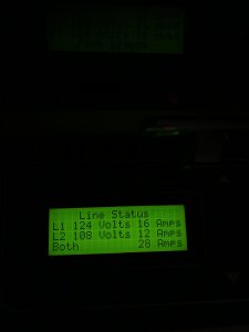

Chugs,I am having a great time and the power goes out. Go outside and the breaker had tripped. Park Ranger comes and promptly replaced the breaker...we’re back on.

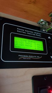

I notice a huge disparity between L1 and L2 voltage. They called Georgia Power in to look. He arrived about 10pm...wow that’s service!!!. They saw normal voltages.
Next, I looked at the remote display on my PI surge protector. Hmmm...normal voltages. So, following the course I removed the cover from the load center and measured voltages...normal voltages. So, it comes down to my PCS Control Panel is flakey. Reboot didn’t seem to work. I went to generator, and it seemed to even out there. For some reason shore power is displayed completely wacko.
Hopefully, when we plug back in at home...the voltage will normalize. Or, I’ll be getting a new control panel or load center to fix the anomaly. Probably try replacing the data cable terminations first.
I wish these things would happen when its NOT 95 degrees outside...in blistering sun.
Chugs,Bully,
Thanks...
It seems I have a problem I haven’t worked thru before. It’s a bad ground somewhere. Might be the cord reel...or I’ll check the pole again.
