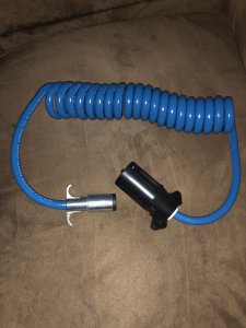

Hey Neal, I just received my new cord from amazon and this is what came! It's the old style Cord, Im not sure what's going on, I was expecting the new cord with the sealed ends.
That is the old style. Black ends on both ends is the new style.
