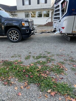

Finally got all the wiring done to use my 2016 Colorado as a toad. Got it hooked up today and am about to leave for the first time. I followed the owner's manual and the last step says to turn your key to the accessory position. I have the brake buddy system with the charge line from the motorhome. When I hooked up my motorhome to the Colorado all my lights and radio operate as normal even though my negative battery is disconnected. Will the light eventually time out? I can power off my radio but the time and temperature still display. Is this a normal situation?
