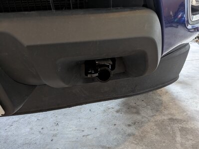

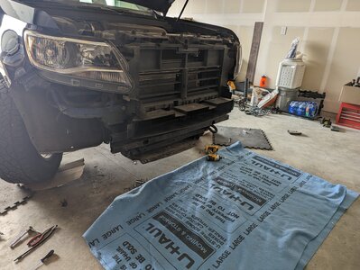

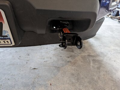

Little update. I experimented with putting the Colorado on a tow dolly. I was not at all excited with how it looked and felt going down the road behind our motorhome. Since then I've started to outfit the Colorado to be towed 4 down. Installed the base plates a couple of weeks ago. It was much easier they I thought it was going to be. I've got the tow bars too. Now just need to figure out what supplemental brake system to go with.
