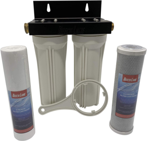

Water filtration is also a good idea, keep those filters changed frequently. I do mine quarterly needed or not. I have various ones from .5 micro to 1 micron as I use a dual filter system for sediment and carbon filtration. Now is a good time to ensure you have the 0.5 micron filters in use. I highly recommend the simple mod to a cost effective dual filtration system that I switched to a year ago and it works great.
Beech Lane External RV Dual Water Filter System: Amazon.com: Beech Lane External RV Dual Water Filter System, Leak-Free Brass Fittings, Mounting Bracket and Two Filters Included, Sturdy Construction is Built to Last: Automotive
Watts MAXVOC-975RV 0.5 Micron Filter Cartridge: https://www.amazon.com/gp/product/B002UC6NIE/?tag=rvf01-20
I'm wondering, @Neal, are you using the Beach Lane dual filter unit in place of, or in addition to, the standard single canister Newmar installs? If using just the dual filter unit, are you using the 1 micro filter cartridge on the input side, followed by the ,5 micron filter?
I've been considering updating out single-canister filter system.
TJ
I replaced the single filter housing with the dual setup. Same filter you use now is first in line followed by the carbon filter.
I’ve had the dual filter system installed for 2+ years now. My first filter is a .5 micron string wound filter followed by a .5 carbon block filter.
