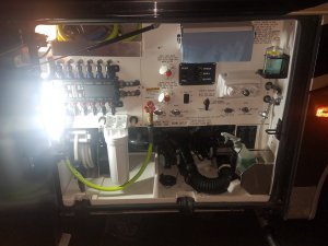

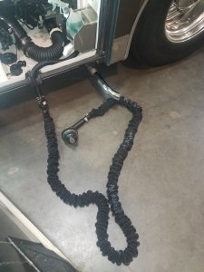

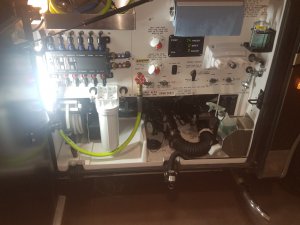

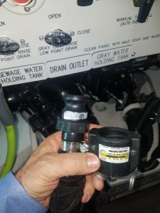

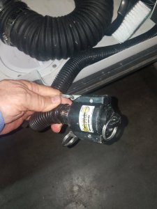

I changed all my hoses (primary and extensions) to add banjo fittings on each end. No fuss no mess just cap it when your done and you are ready to go the next time. It also makes it simple when you have a long reach just snap in the addition and I can reach 50 plus feet to drain. no more mess in storage and I cleaned up the wet bay by being able to store the hose separately
View attachment 1539View attachment 1540View attachment 1541View attachment 1542

Here are the pics of my wet bay and the banjo connectors for the sanicon system. All the parts were sourced off amazon

Thanks for posting the photos, Dave. In looking at them, it is obvious that your Sanicon hose is of a significantly smaller diameter than mine. That would explain why you used the 1" fittings. Well done, sir.
