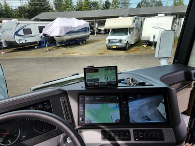

I was in the rig today taking photos for my final warranty todo list for my service visit in a few days and found the GPS receiver puck thanks to the suggestion of a forum member. Instead on being on the roof as I had assumed (previous rig and the Sirius up top of front cap) it was simply tossed under the dash near the front windshield with its magnetic mount hanging onto the dash AC/Heater box.
No wonder the stupid thing doesn't work half the time. They took an external GPS antennae and lazily tossed it up to the front of the dash under the removeble access panel. Ugh.
I had installed a Carpuride Android Auto / Apple Air Play display because I had become so sick and tired of the factory NAV saying "GPS signal lost" or "Looking for GPS signal".
At my service appointment I am going to ask that this GPS antenna puck gets installed on the roof where it belongs...

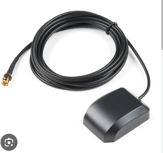

It looks something like this (ignore the connector on this "stock photo"). I took off the top access cover of my dash (velcro-ed on) and saw that thin wire coming out of the head unit. Traced it about a foot or so where the dash approaches the center of the windshield (below where the MobileEye is attached to the glass) and its magnetic bottom was stuck to the side of a metal box. This wire to the antenna puck normally runs up one of the A pilars and out a hole on top of the front cap. Instead of running the wire correctly and sealing around the hole and the antenna with sealant I guess they decided tossing it under the dash was "good enough".
