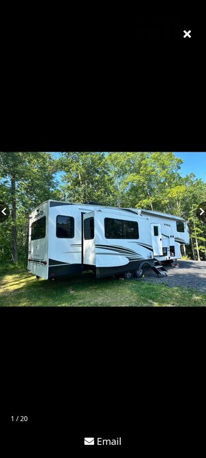

Have bought a 2021 jayco eagle ht mb31. Having issues with my furnace. Lights and blows warm from the floor vents . The jayco command app has only on and then low fan speed which turns on the ac fan in the ceiling. Shuts off after alittle while running . Was thinking it should heat my rv without trouble but..... any tricks I need to know . Could it be the battery's. I'm hooking to 30 amp service btw .
That's the rv
