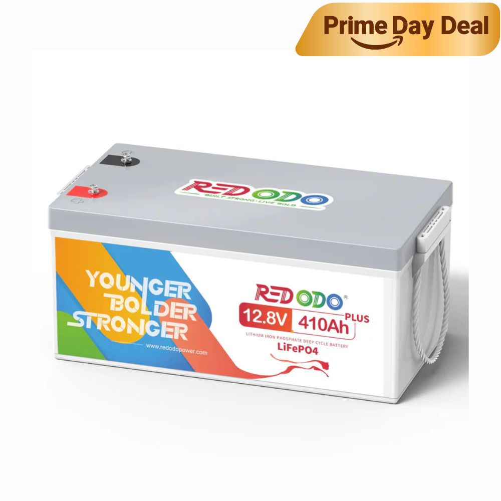

While looking into the Lithium myself I came across this company. Seems their prices are cheap, but I don't know much about batteries. Redodo Power—Lithium solar batteries and RV batteries!
They do have one battery that will replace all 4 of my lead acid ones.
🤔 re-dodo?
Neal.
