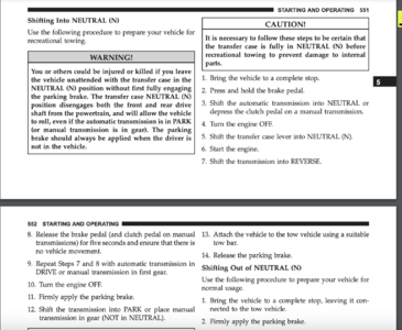

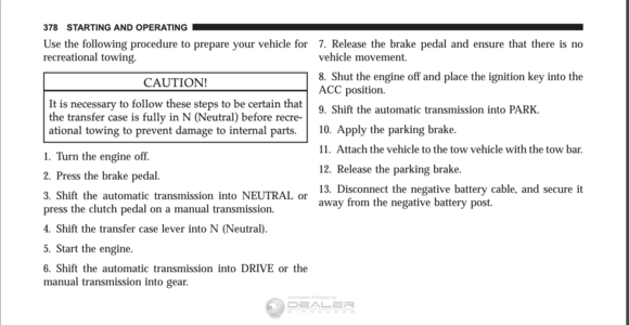

As I originally said some are gear driven and newer speedos are electronic. Either way, you follow the owners manual and you will not add mileage. The mechanical is disconnected when the transfer case is in neutral. And without power, a hall effect speedo, if that is what they use will not work.
The first picture is the owners manual for a 2009, must disconnect battery cable because the steering wheel will lock if the key is in the off position.
Second picture is an owners manual from a 2015, turn key to off. I know there were a few quirky years where you had to disconnect the battery. I owned a 15 and knew the steering did not lock in the off position

As I originally said some are gear driven and some newer speedos are electronic. Either way, you follow the owners manual and you will not add mileage. The mechanical is disconnected when the transfer case is in neutral. And without power, a hall effect speedo, if that is what they use will not work.
Agree with the 2009 stuff I already had it downloaded and have a battery disconnect switch installed.
In one of my previous comments about the mile running up I stated it could have run up if the power was left on while towing. Just wanted to test that.
