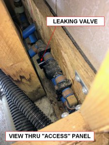

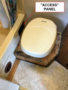

I have a 2002 Coachmen Pathfinder Sport which is new to me and I'm working on a water leak in the freshwater system. The leak occurs whenever I pressurize the system, and I've tracked it to the lower valve in the exterior water panel. The only interior access to this valve is through a small access panel in the sidewall of the bathtub, behind the toilet. Just enough access to reach around an touch it with one finger, but not to work on it.
When I found the leak I thought there must be a way to get to this valve by removing the panel from the exterior of the vehicle, but it doesn't appear to be the case. Reaching from below would require the removal of the black water tank - yikes! :oops:
I frankly can't believe that they built this without any means to service these very important valves. Surely there must be a repair option that I am overlooking.

Thank you for your reply. I've added some photos with doodles to help illustrate. Photo 1 is from the outside, showing where the leaky valve is. Photo 2 is of the so-called access panel in the side of the tub, and photo 3 is looking through that panel. It looks to me like there might be shot at it if I remove the toilet and cut away that wooden bathtub support you see in photo 3. Then maybe there is enough room to work on the valves. I am pretty disgusted with this design.

yeah, that's pretty poorly thought out by the manufacturer - probably not thought out at all. I would certainly have to pull the toilet to get enough room to work with and I'm a small, wirey guy.
Is the rest of that interior facing tub side not easily removable? Seems the easiest way to access it would be to remove that if you can.

Hmm. I hadn't thought about enlarging the access hole in the tub. I'll have to think about it.

As I've thought about it, I'm wondering about cutting out the mounting panel from the outside using an oscillating saw to plunge cut my way around. Then, perhaps I could add some extra length to the pex to allow the panel to be removed from the outside for servicing the valves..

The valve is leaking inside, but seems to be mounted to the panel, which consists of the white piece with the graphics (which can be seen from the outside) and a piece of OSB which is about 1/2" thick. My thought is to cut through both, including the water lines on both sides, then reconnect with new hose. It is a bit risky, and I'm mostly thinking out loud.
