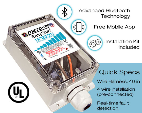

I was contemplating installing easy starts on the ACs in the coach . For those running them, a question. Do you think it's worth the $ if running on 50a 99% of the time? Just wanting to ease the load on the units.
They do extend the life of the units by ensuring good voltage and amps by starting the compressor after yhe fan.
I have 3 installed and run 2 on 30 amps w/o and issue, even with other loads.
I would opt for the Bluetooth ones that way you can monitor startup and runtime values
I can only tell you that before the soft start capacitor I couldn't turn on the microwave in my 30 amp coach while the a/c was running without an overload and trip at the pedestal. After, I can run the microwave or a toaster with the a/c running without issue.

For those that have them, is bluetooth really worth the added cost? To me, the simpler route is usually the better choice, but not sure just why they would need monitoring.
No BT for me, don't care about it. Just want it to do its job of "soft starting." With that said, I have no clue what the BT offers with this unit, it's new after when I bought.
I purchased the EasyStart soft starts prior to my Canadian trip as we were informed most parks had 30 amp service only and that depended on them having electric service. (lots of outages & brown outs) They are well worth the money to me as I could run two Acs on 30 amp. However not the Acs and a microwave or cook top. You have to decide what you want on a 30 amp service. I do believe it has extended my Acs life as one of my units is the original 2016 unit. As far as bluetooth option probably not worth the cost since I have bluetooth units. Using the bluetooth you can see how many starts, amp draw starting and running and a couple other parameters. I was really surprised at how many starts an AC goes thru. (thousands) With bluetooth you can connect to the unit and then connect to EasyStart where they can see the unit and help diagnosis issues. Hopefully the OEM unit makes it thru this years trip.
